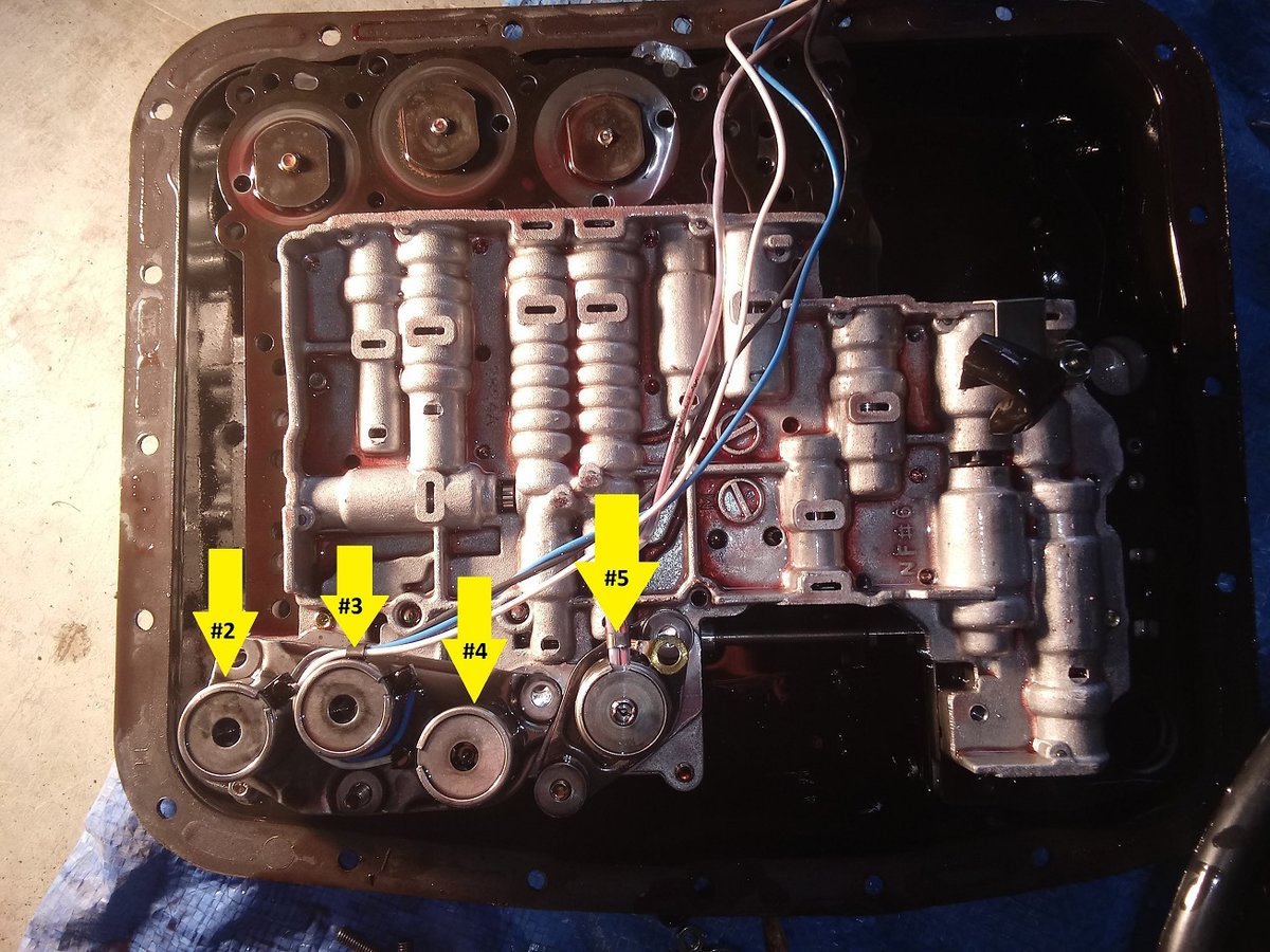

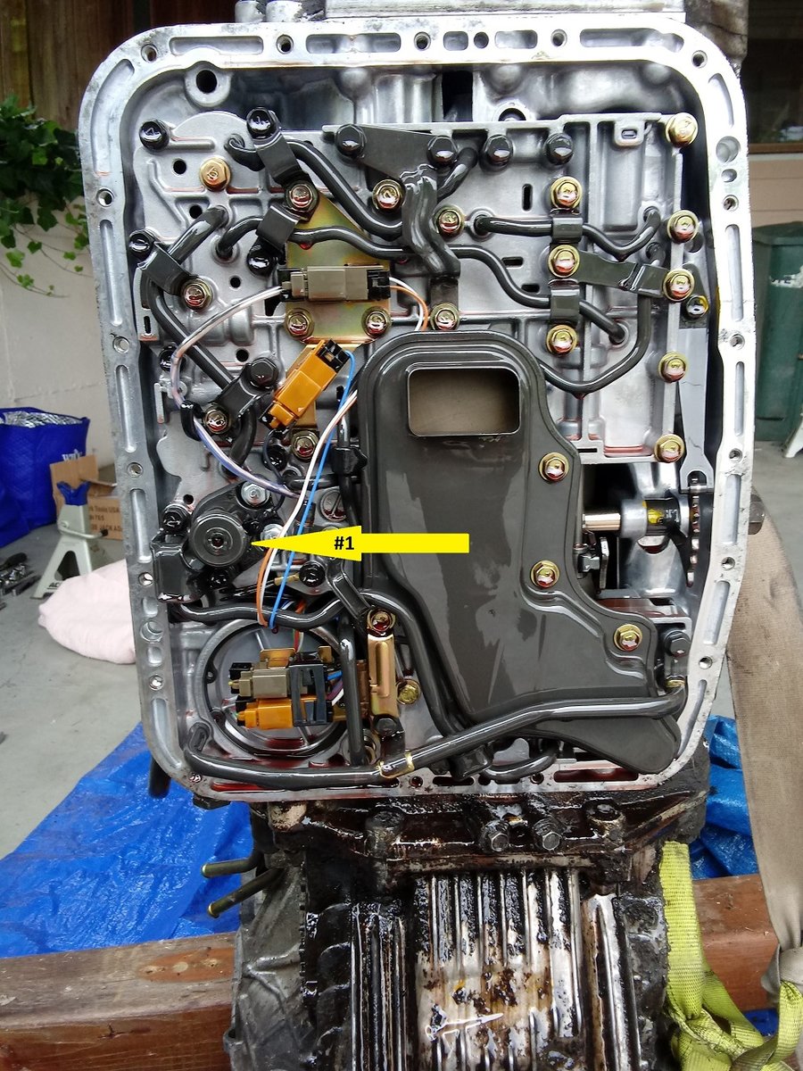

I took apart my old transmission to cannibalize the solenoids from it., but I am having trouble Identifying each one. I have labeled each solenoid with yellow arrows 1-5. If anyone knows which is which and what the resistance through the good solenoids should be I would be very grateful. I plan to replace all of the solenoids inside the oil pan with my old solenoids because I did not have issues with shifting with my old transmission, just binding.  But if I could avoid opening the valve body area to access the rear 4 solenoids I would be happy as a guy who doesn't have to get transmission fluid all over his face, twice.

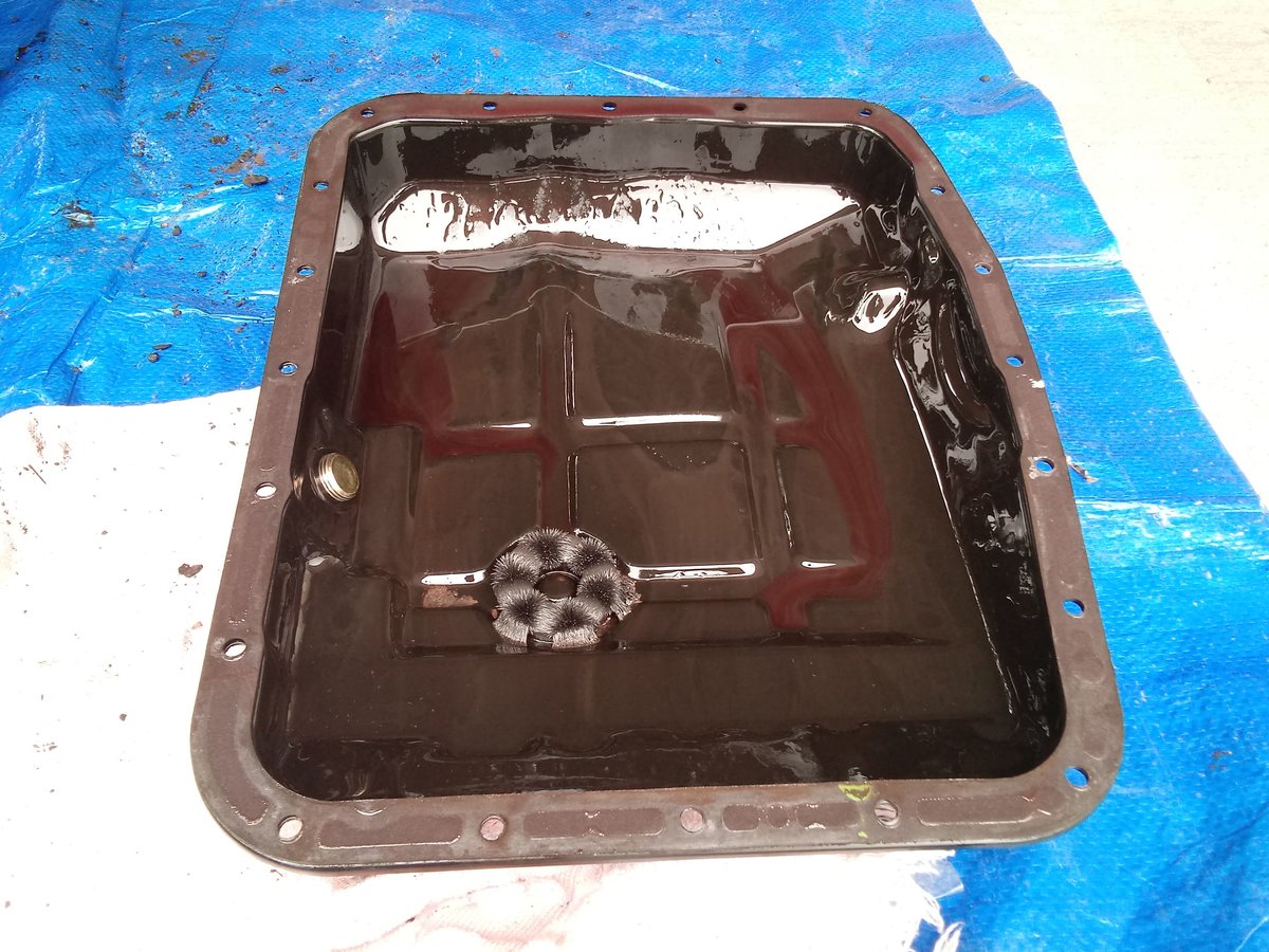

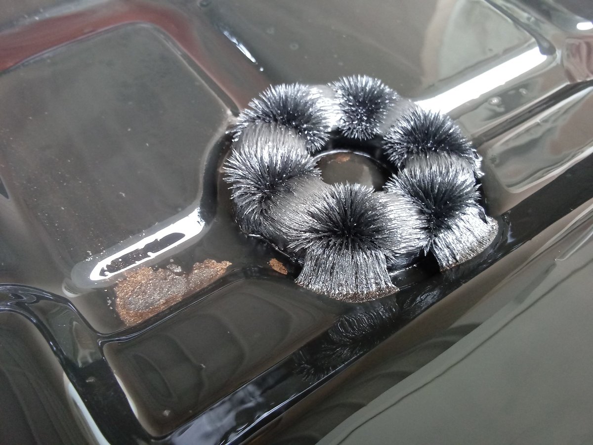

Take it back for the warranty.
It's junk
What kind of junk?? Like lots-of-work junk that I can drive for the summer, or unfix-able junk?
If I cannot fix this issue, everyone in my life is insisting I donate the car to a yard, and I really don't want to buy another car.
If you paid for a warranty, use it.
Have the yard where you bought it get you another trans.
It's not working.  That means you get another one.
That's what warranties are for.
It's also why I pull the pan on engines and trans before accepting them from a yard.
what he said ^^^^^
you paid for the warranty - now get your moneys worth.
I honestly can not believe that anyone told you that amount of metal shavings on the magnet was "ok" - there is no way in hell I would have even put that tranny in a car. that is just nasty looking.

Okay, so the warranty is about to run out on the junk transmission I got last year, I went to the yard today because a donor car finally showed up. But it does not look promising. I dropped the oil pan on the transmission and it smelled pretty terrible, not burnt, but almost putrid. It looked black to my eyes, but in the photos I do see some red. It looks slightly better than the current transmission that I have.
What are the chances of this thing working?? I hate to install another dead transmission, but I dont have many other options.
Also, what would a transmission in "good condition" from 1993 look like?

1. that ATF looks horrendous. maybe it's a deceptive photo but your description doesn't seem to suggest that.
- It does look terrible, yes. But I am wondering if I flush it 2 or 3 times if there might be some life left in the transmission.
