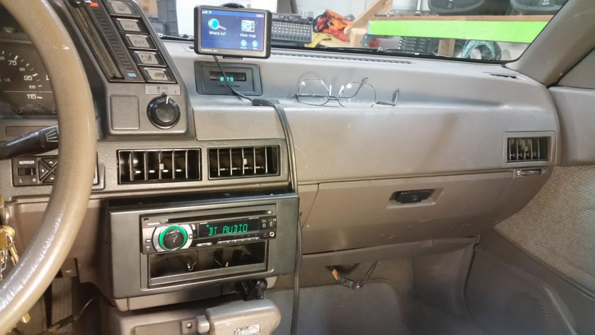

It's nice to have a real stereo in a car again.
