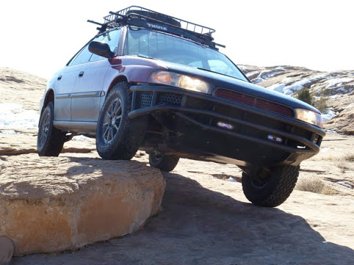

1995 legacy L
99 OB struts (KYB GR2)
99 FOR springs in rear
94 SVX springs in front
27x8.5 14" General Grabber AT2
Posted Image
Posted Image
Posted Image
Posted Image
Posted Image
Posted Image
Posted Image
Posted Image
Posted Image

i love that bumper. something says i can't get one though.

I want one of those bumpers for my 90 legacy wagon. They're fricken sweet. Where did u get it from. I wonder if i can mod it to fit my car or if it will just bolt in, that would kick rump roast :headbang:

mudrat in Eugen, OR
This one wouldn't fit the first gen legacy, but he'd build you one that would!!
http://www.oregonoff...drat_index.html
