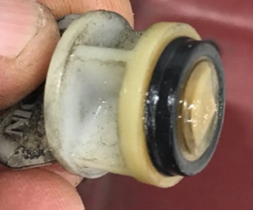

84 GL, petcock broke off, what to do?
mkoch replied to mkoch's topic in Old Gen.: 80's GL/DL/XT/Loyales...
Thank you, Naked Buell. The broken piece was in there so loosely that I was able to tease it out with a knife point. , just waiting for the part now. -
Sigh, this could be an original radiator. The petcock broke, and I was fortunate enough to discover it after only 3 minutes of driving! Is there an easy solution to this?
