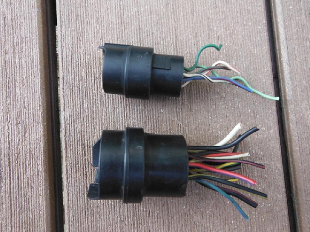

  1. you are right there is a red and blue wire there, i tried it but i still cant seem to get the check engine light to work, any other suggestions? there is a brown wire, a yellow and green one, a black and white one, 2 white and blacks ones and a light green one, and a white wire coming from the plug behind the lights
  2. there isn't a yellow and red wire or a white and red wire coming from the check engine light plug
  3. it is a 1990 loyale i have it hooked up to a yellow and red wire but its not working, where might it be located?
  4. I have searched the forum for many days, yet i still cant find what color the wire is for the check engine light for the loyale i apologize for asking so many questions lately I have just been kinda lost

  12. I am currently swapping an ej22 out of a 1992 legacy into my 1990 Loyale. Everything is done except the wiring. i got my harness from SJR, i currently have the 3 yellow wires labeled hot in run and start and hot at all times wired directly to the battery (Just temporarily). the black and red wire labeled fuel pump is wired to the blue and white wire from the old fuel pump relay ( the fuel pump was working but its not anymore) the alternator is wired up to the original wires from the vehicle. (The charge light was flashing while cranking but its not anymore) the wires labeled starter, trans, coolant, fan. radiator, select monitor, oil pressure, ac, check engine, and tach are not currently connected to anything my question is with this current setup is there a way to get it started it currently cranks over fine and the fuel pump was pumping but there is no spark im a little lost at why there is no spark and what happened to the fuel pump i know grounding could be an issue but i don't really know where to start, does the ecu need to be grounded and if so how also i don't know if there is a minimum voltage the battery needs to get everything going it currently has 12.36 volts i have read through several other peoples threads including numbchux, but im running out of things to try, the engine ran fine right before we pulled in out of the donor vehicle i suck at electrical so any help is greatly appreciated thanks
