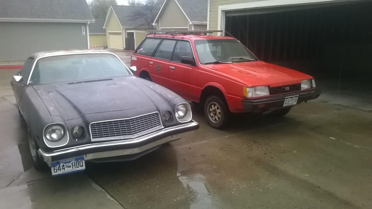

Another picture of my 77 Camaro and my girlfriends 86 GL. Now she has an ej22! The Camaro has been slammed too, giving her the perfect stance! Two inch lift on the GL, two inch drop on the Camaro
