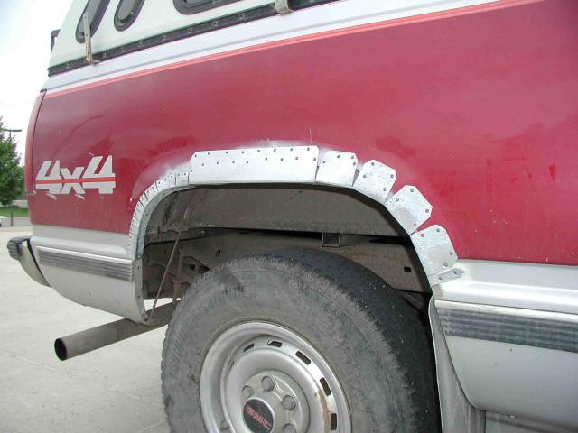

August 6, 200916 yr here is an example of the mad max repair method I'm doing on my truck. 1. The metal i used is extra roof flashing. Galvanized!!! 2. Cut out bad rusted metal. 3. Spray with rust inhibitor or really good primer. 4. Attach metal to body and hold in place with clamps or vise-grips. 5. Drill holes. 6. Attach poprivets. rivet gun from loca chain hardware store (Menards up here). 7. Optional now: Apply bondo over repair job. Attach flexible fender flare or spray on bed liner. 8. Wallah!!
August 7, 200916 yr Opel, I like that! With a little fiberglass you could give it wings! Or make it vanish.
