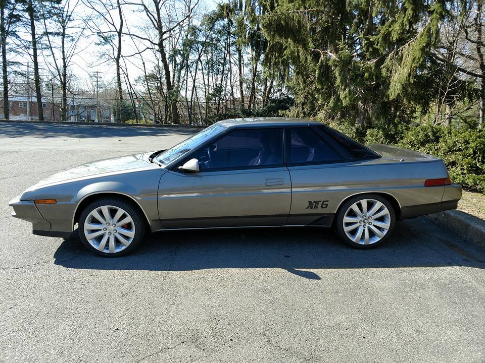

Spring is here and I'm tinkering with my 1989 XT6. It sat in the garage for the winter, with a trickle charger and a weekly startup. I recently did a complete reseal of the H6, timing belts, water and oil pump, etc. It runs like a top, starting right up and idling perfectly after a cold start. I let it warm up to the point the fan kicks in, cycling the cooling system. When I shut it down and restart it hot, the idle RPMs shoot up to 1,500 or so and stays there, something is convincing the ECU to do this I guess. I cleaned the IACV, MAF, throttle linkage and all the wiring to them. I get 3.2 volts at the CTS wiring plug (I replaced the original with an injector harness). The CTS seems bad, it's 30 years old! I read an open circuit between the two conductors, tested when warm and then hot. I will check again when cold and hot, but an open is bad when it's hot and should be talking to the ECU. I'll try a new CTS first, they're not expensive. Questions... Should I get a $15 aftermarket CTS, or the good old NOS Subaru CTS for $40? The original lasted 30 years, so I'm leaning towards NOS Subaru. Any other suggestions on this issue? I can drive the car all day after a cold start, idling at a stop around 750 RPMs but if I shut it down and restart it hot after a few minutes, the idle zips up to 1,500 and is reluctant to settle down. I could check for vacuum leaks, but figured if this caused the high idle, it would occur even with a cold start.
