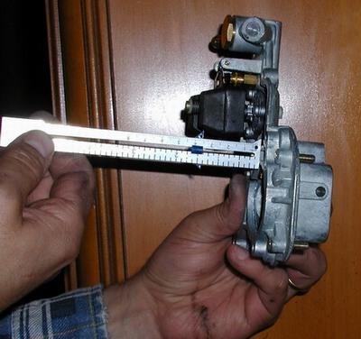

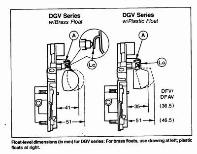

bogging acceleration after adding weber
chef_tim replied to subestyle18's topic in Old Gen.: 80's GL/DL/XT/Loyales...
Check the drop and rise of the float also.You may recognize this "tool" from granies sewing box, it is a "hem" measurer from walmart apx. $.89!!! -
