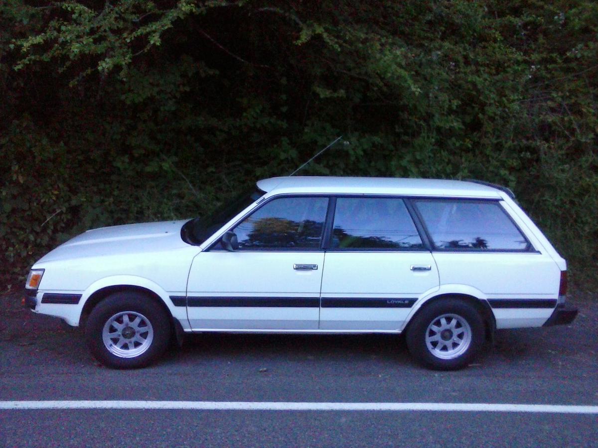

June 8, 201411 yr Driver's front done on the Loyale. It was a band-aid axle I rebuilt that was on my GL and only meant to be on there for about 1k. It was on there for about 4k miles. It did it's job.New axle was a bitch.Changed oil, mobil 1 + filter. New air filter. Adjusted timing but it was only off -2*. Still got my slight hiccup. Oh well.
