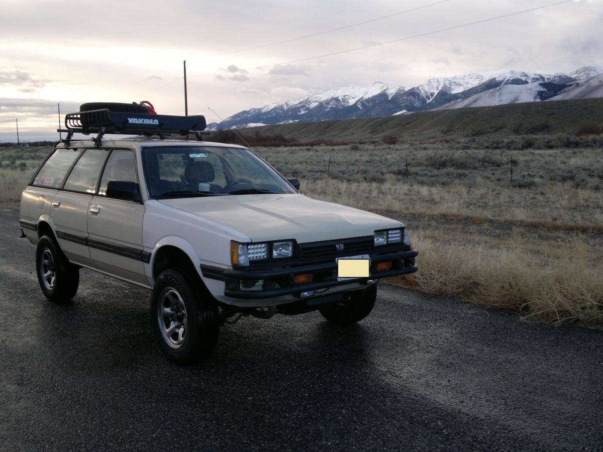

Installed 4x6 LED headlights outboard on my GL before house hunting trip to Montana. This trip would've been better with an EJ engine but this the last hurrah for this EA82. Its a dog but a dependable one. 1380 miles in 3 days of rowing the stick on hills.Had to strike while the iron was hot. Pic is along the 28N in Idaho approaching the 93N then thru the Bitterroot Mtns. on way to Hamilton MT. https://www.google.com/maps/place/Bitterroot+Mountains/@45.8001599,-114.4418378,9z/data=!4m5!3m4!1s0x535915a184e5f8c5:0xfba63605bbcae42b!8m2!3d45.8076982!4d-113.9389673 Saw a herd of pronghorn antelope along the way.
Drove 1500 miles already & nobody has flashed their beams yet. Mine have top row & center rows of LEDs for low beams. SAE print goes to top of lamp. Low beams following another car I just keep back far enough that beams don't meet back window of car ahead. Tractor-trailer rigs around here have them too.
I replaced my outer pair of 4 x 6 lights with these: https://www.ebay.com/itm/4X6-LED-Cree-Headlights-Sealed-Beam-Hi-Lo-Bulbs-White-6000K-Head-Lamps/252638282642?ssPageName=STRK%3AMEBIDX%3AIT&_trksid=p2057872.m2749.l2649 Low current & very bright.
