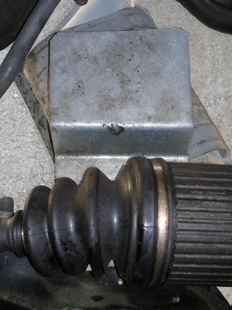

Be sure to put 2 step bends in that heat shield so air can circulate between it & the cat converter. Like a lazy Z shape. I attached mine to the cross member with 2 machine screws at the rear edge above the cat.
