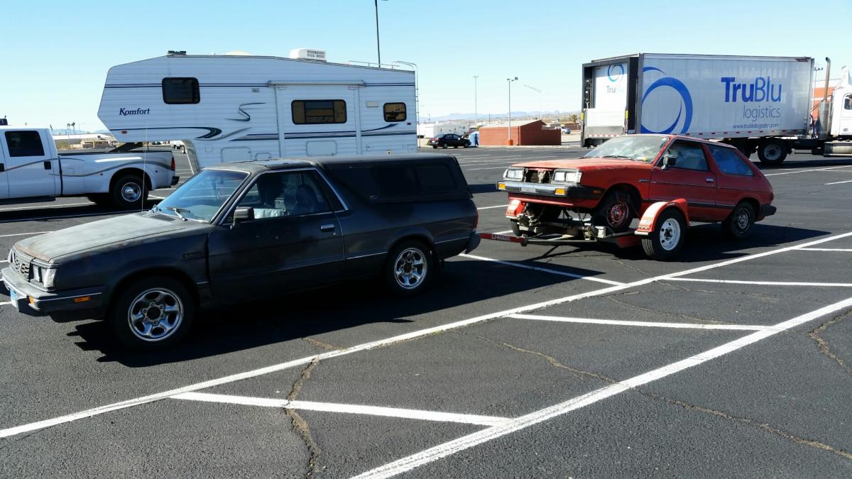

February 8, 201610 yr Just took a road trip to rescue my '85 from storage. Averaged 17 mpg while towing it the 400 miles and made a lot of road trains lol. Both cars are also filled with stuff from the same storage unit. Total weight was probably just over 7000 lbs

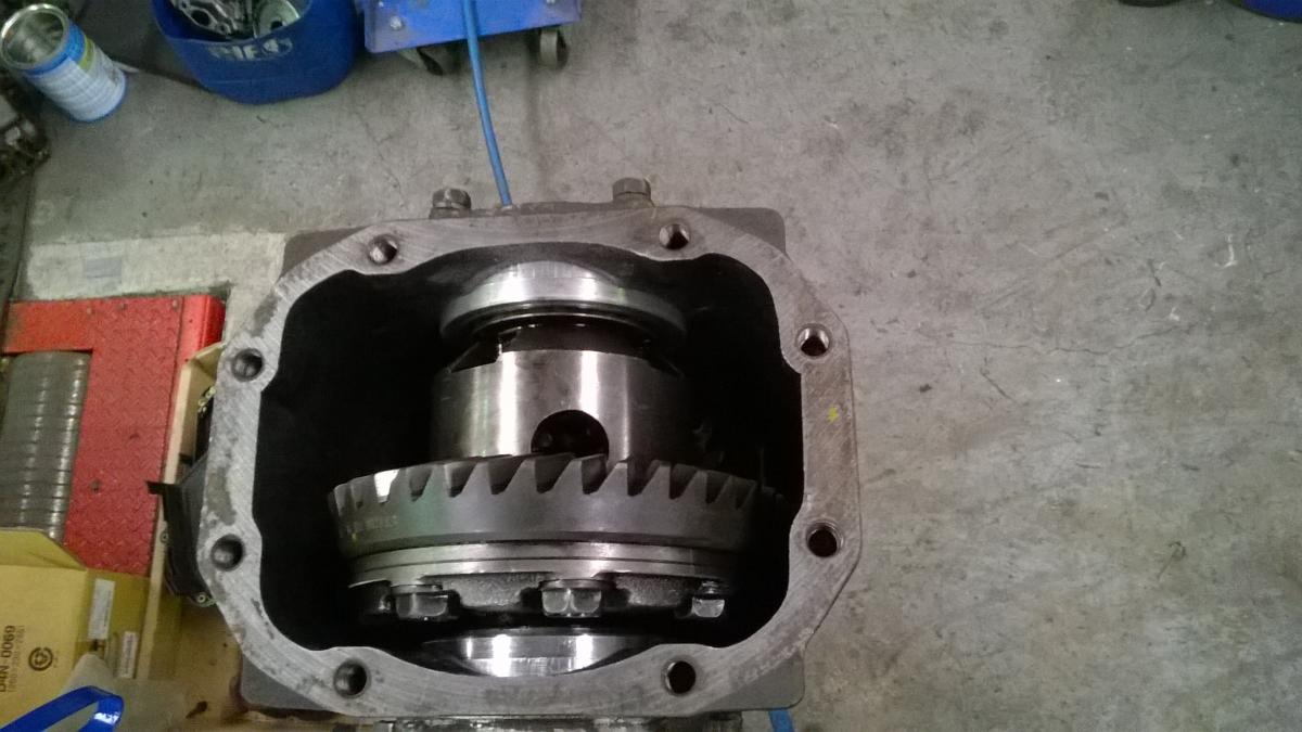

April 25, 20169 yr Finished installing the Viscous LSD centre from a Gen I Legacy GT into my rear diff. Ended up having to cut one of the original stub axles off because I couldn't undo the Torx bolt in the middle. Swapped the crown wheels over. Chamfered off 2 adjacent ridges on the diff centre so it would fit inside the casing (FYI, some later models need the bolts sealed because they protrude through the outer case).
