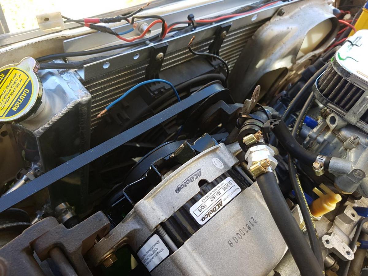

Next was replacement alternator. $175 locally here in Aus, got this one from rockauto to the door for $90. Cheers.

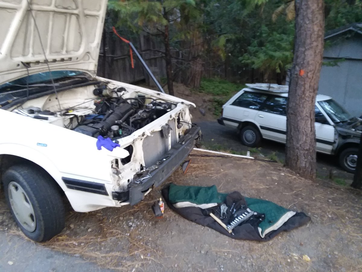

Just pulled my engine out of my loyale, pretty proud my very first engine pull :)

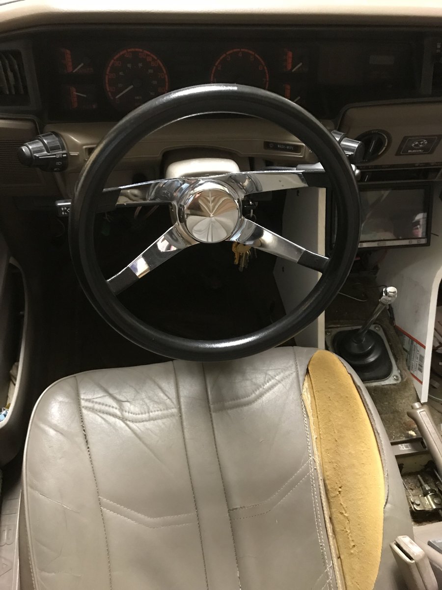

Well, I couldn't find an old ratty wheel to cannibalize for my aftermarket wheel adapter, so I just used mine.
Made a plastic bushing to center the pilot bit, and holesawed away.
Then flattened out the little bend on one edge with a BFH, and drilled and tapped for the new wheel.
Best thing about this method (other than being cheap) is the horn and turn signal cancel cam work just like factory!

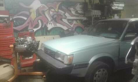

@sparkyboy - any words in the form of a description as to what’s actually happening there?  Got a new project? Pulled the EA82 turbo for an EJ20 turbo?? Putting an EA82 turbo in???
Too many questions raised.
Cheers
Bennie
@el_freddo
You posted in this thread! Member? You member
Yea the one that followed me home! She's getting some love, hgs and timing crapola while my lovely swapped 86, 85 xt, camaro and bel air :mad: (family project, but I've F'n BEEN ready!)
Lol! Luckily it snowed lately and I've not much better to do :lol:
I was trying to match my bros arty bmw s52 swap pic since i was slacking this was at the same time as the ej22 swap into my red gl. The art was done by an old friend.

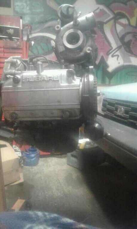

The turbo is a spare for my xt :P but period correct I guess, vf4
Ideally I would like to put the xts ea82t into the 88 gl and put an ej22 in my xt :lol:

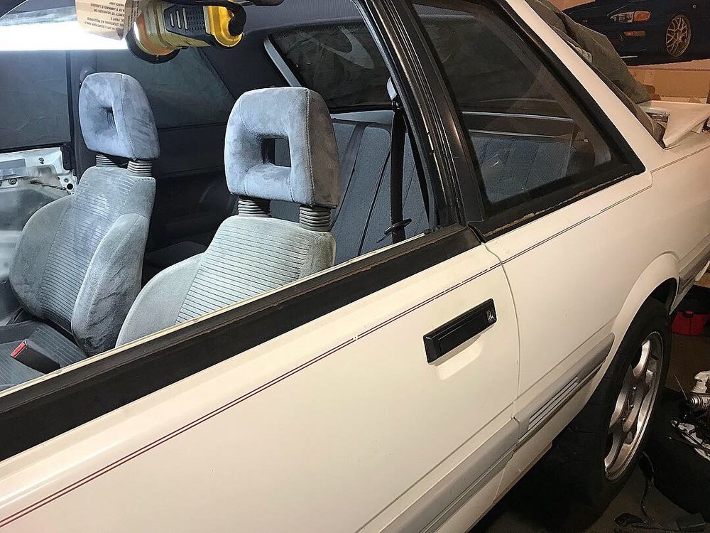

Picked up and installed 87 XT seats in my 91 RS.. the stock seats had to go and I'm trying to get to as close to an XT6 as I can, just trying to re live my high school days lol.
