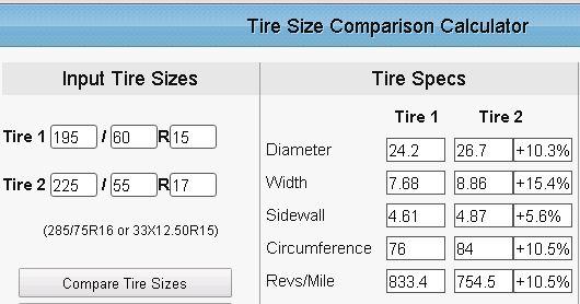

  17. Hi, No offense to Matt, but pretty sure those will rub on the strut perches - right where the bottom of the strut spring is supported. The Xtrek tires are 2+ inches TAller. See attached. You COULD buy the set and either trade or sell>>buy some Shorter 17" tires that would fit....205-50-17? I think the 225 are too w-i-d-e, as well. Here's my new favorite tire size reference: https://tiresize.com/comparison/ Edit: Per cars101.com the '95 Impreza had the following options...from base>>Outback. So yours have been swapped out previously if they're 15", which came stock on the '97+: '92-'95: wheels/tires 175\70SR14 steel wheel 195/60HR14 with steel wheel 195/60HR14 with 5 spoke alloy wheel on sedan, steel on other models, O- alloy wheel 185/70HR14 Raised white letter all season. Steel wheel with hubcap. 5 spoke alloy wheel optional '97+ Wheels/tires 15" steel 195/60R15 87H 15" Alloy 205/60R 15 16" Alloy, Gold colored honeycomb 205 / 55R 16 89H GL, Td
