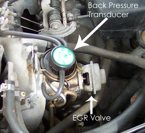

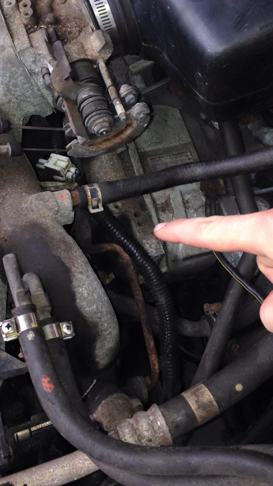

Hello. I bought a '97 legacy L automatic car. Not knowing that aperently the manual cars are lacking the EGR system. So needless to say I have a CEL I need to make the auto ecu communicate with the manual motor. How can I get the car to work without EGR? First pic is my car second I found online of what it should look like

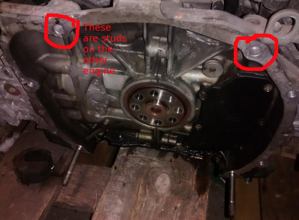

I've been working on swapping an engine from a 99 legacy outback (manual transmission) in to a 98 forester (automatic transmission) I finally went to put the engine in the forester today and noticed the one of the studs on the engine wasn't protruding through the transmission bell housing. So I looked over the old engine I had pulled from the forester and noticed that it only had two studs on the engine whereas the one from the outback had four. After many creative searches and reading many threads I had decided to see if anyone in this community of knowledge has any light to shed on this for me. This seems like an uncommon configuration for the studs on a EJ25 as most pictures I have see only have the two bottom studs. So can I pull the stud from the engine and just use the old bolts off the forester as I was planning to do? If so how do you remove the stud? Are they any other weird problems that I am likely to run into and should gear myself up for? It seems like 99 was a magic year for the EJ25...... Since I am writing this up I had one question regarding the lining up of the drive plate with the torque converter. Is there an easy way to line up the bolt holes or do you just have to guess and then move the drive plate by rotating the engine. I have it lined up now, and I doubt it will get out of line when I pull the engine, I'd just like to know if there was an easier way in the future. This is a picture of the engine I removed. I did find a picture of the an engine with the stud configuration like mine.
