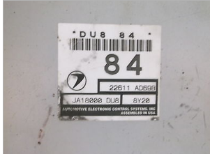

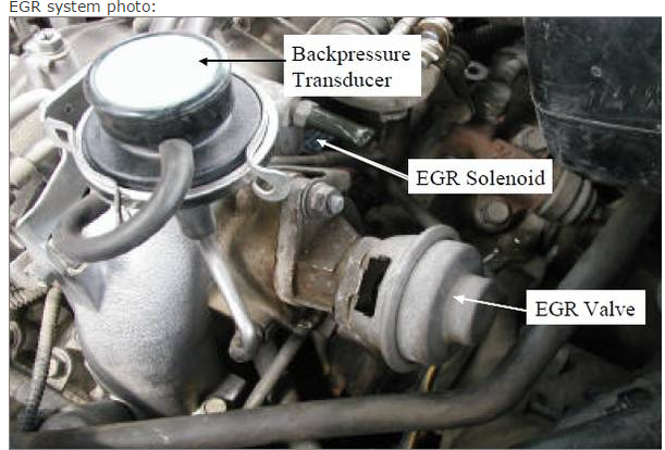

  21. ALL 19996 - 1999 Legacy 2.5's were the EJ25D, and had EGR. That ECU should end in the letter 'B' not # 8....should also be labeled # 84 - see attached.>>>it's a 1999 EJ25 ECU and should run ANY '95-'98 EJ22...but it's looking for EGR. If you don't have EGR on whatever you have in there, you MUST add it. Only way I've seen that works is to install a '95-'98 EJ22 IM - EJ25 DOHC won't fit - w/the EGR. You do NOT need to add the port to the head. DO THIS MOD. All EJ22 w/Automatics had EGR; some of the 5-speeds, AFAIK. If you DO have EGR then look into replacing the Backpressure Reducer (used is fine...Toyota's work too!) as it's easy and fixed my CEL when it failed. Or try cleaning the actual EGR valve. Also, there were differences in the vacuum lines due to the Charcoal Canister being moved to the back on the '98-ish Legacy Wagons (my '96 EJ22 Sedan was in back, too). Look on here for more info to confirm your setup.
