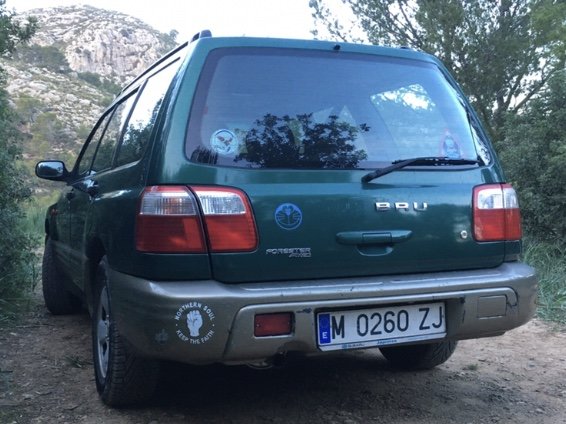

Here is our new twenty-year old lugger. ’00 SF 2.0i. Solid, rust free, 140,000 miles, 5MT dual-range. It needs a few of the usual bits fixing: axle boots, oil seals, new plugs etc. etc. but it runs fine and vacuum gauge reads a healthy motor. I have a howling rear bearing and tired rear drums. Perhaps I can swap the broken Legacy’s rear hubs complete with disc brakes to save some money.... So we now have two Foresters; a fine team.

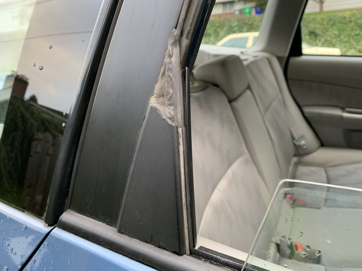

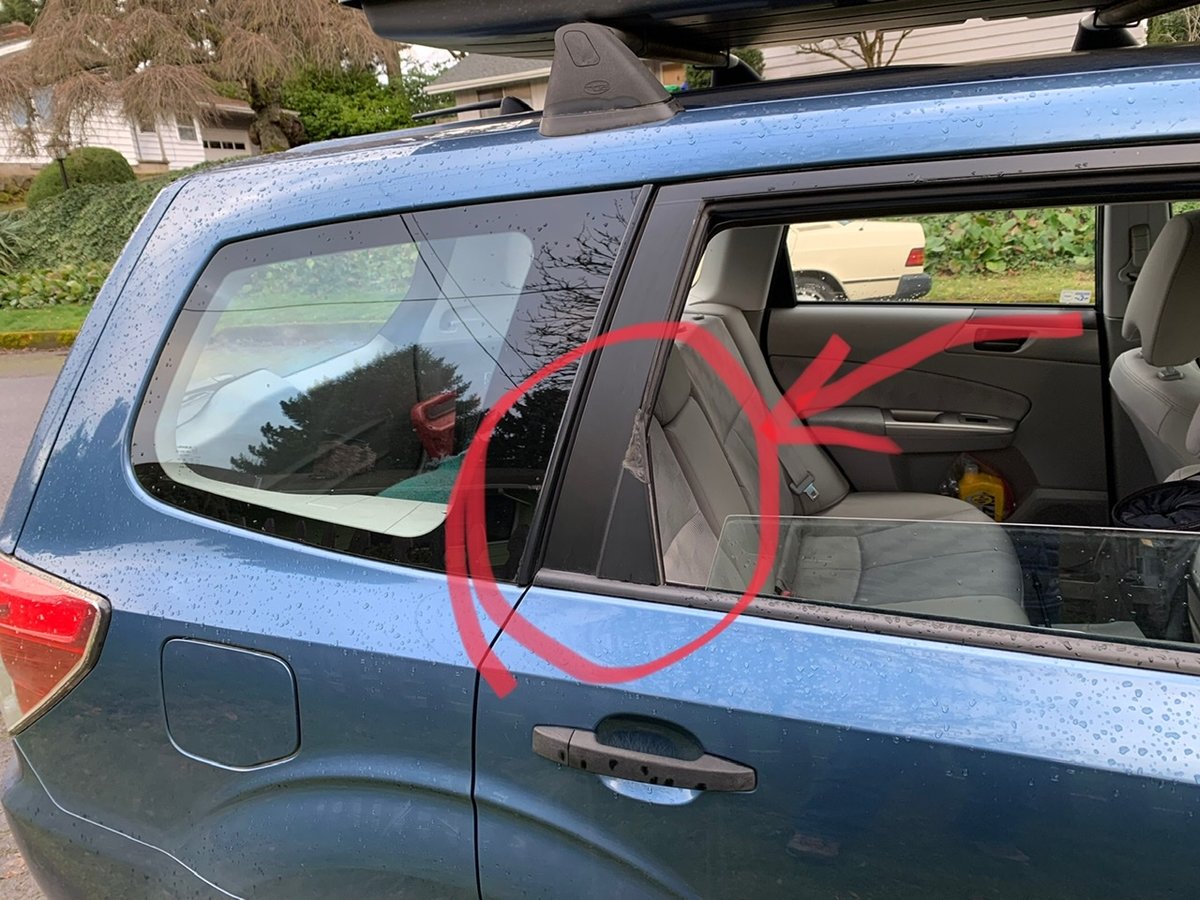

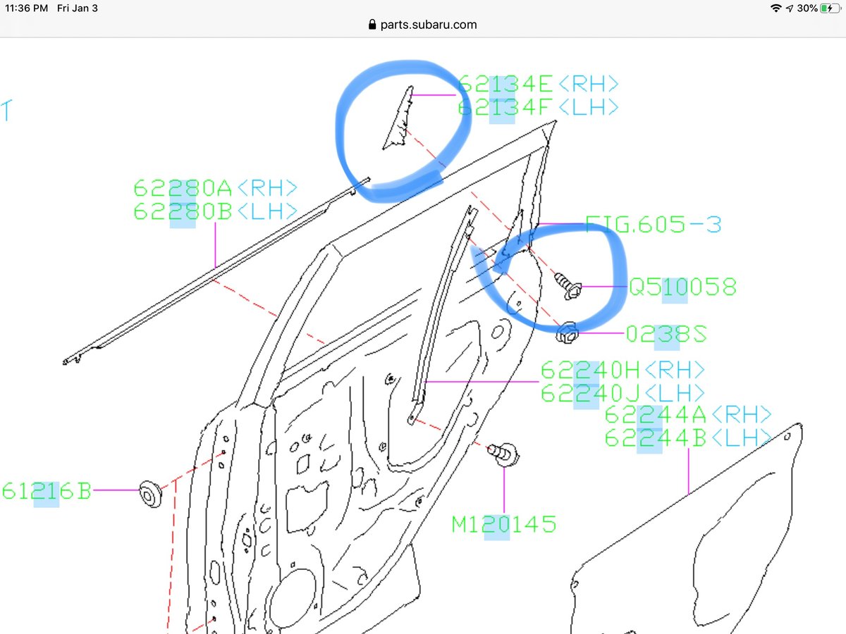

Hello! New member here. I have a 2010 2.5X with a broken rear door gusset. See photos. I’ve temporarily sealed the gap with some putty-like coax seal. I have a replacement part ready to install (see photo), but I don‘t know how to remove the broken gusset piece from the car. There’s many a YouTube video explaining the front door gussets, but nothing I can find regarding the rear doors. There’s a plastic clip in the new part. Is that the only thing holding it in place? Would a plastic door panel removal tool do the job? Is there any glue involved that would require heating with a hair dryer in order to soften it? I’ve seen schematics that appear to indicate a screw that I think would need to be accessed from the inside of the door, but I’m not totally sure on that. The schematic is confusing to me. See attached. Any help is much appreciated!!! Thanks very much. Gordon The new part, waiting to be installed...

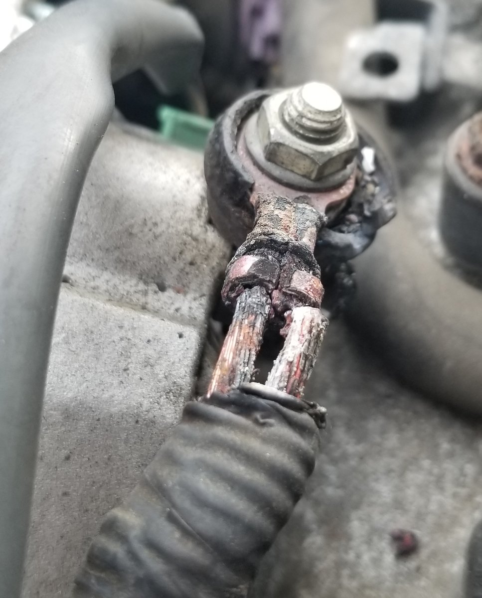

I was trouble shooting the cause for a small fire at the base of a new alternator. I found fried wires and I am having trouble getting the correct replacement. Can someone please help me with this? When I followed the wires down they go into the bottom of the fuse box into a black port. I also found they had been previously spliced and I am not sure if this is aftermarket or how it comes.
